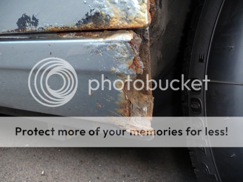

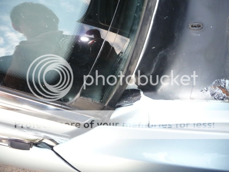

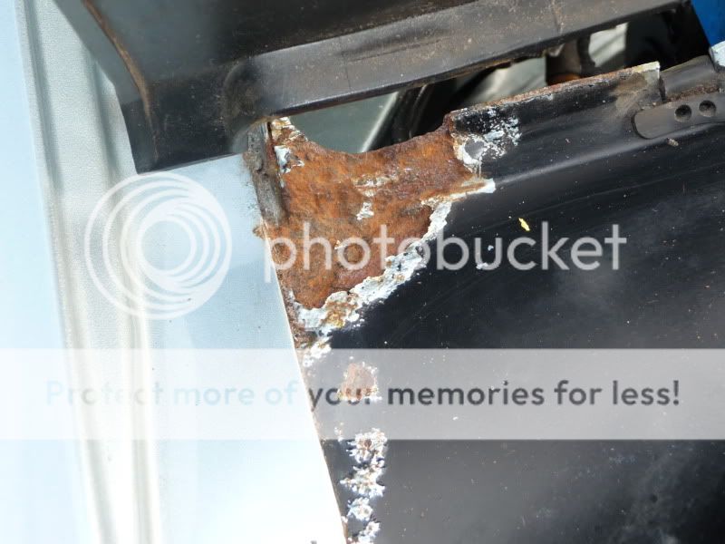

Late XJ40s are very strong, reliable cars in the main with especially long lived mechanicals. Rust is what kills them; like many cars made before the 1990s they do like to rust! Close up of the right hand sill reveals this horror. The sill end design wasn’t one of Jaguar’s better moments – soil builds up behind the plastic wing liners and holds water. Mine is worse than many cars, but most XJ40s have some rust here. The bulkhead on my car is far better than most battery in boot XJ40s, but the top of the scuttle panel has the usual rust on both sides. Seeing under the wings of other XJ40s (mainly photos on the internet) made me realise the rust I could see was only a hint of what lies under the wings, unseen. Rust here is the major cause of the wet footwells suffered by many XJ40s. On the right hand side: And the left. Good bulkhead: But yikes! Problems lurking there… Less typical on the XJ40 is the rust in the right hand door pillar. It is difficult to photograph but was quite advanced and includes a substantial hole! I was worried about this because it could be a symptom of serious problems within the structure. Though there is no rust visible in the pillar from inside the car. I tried to work out what could have caused the rust. This is how the cars are constructed.

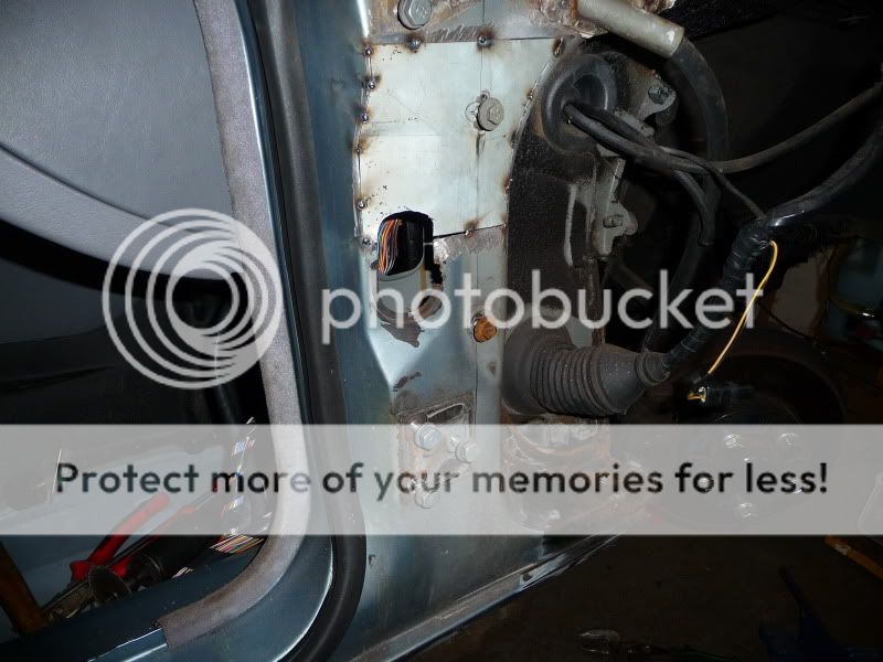

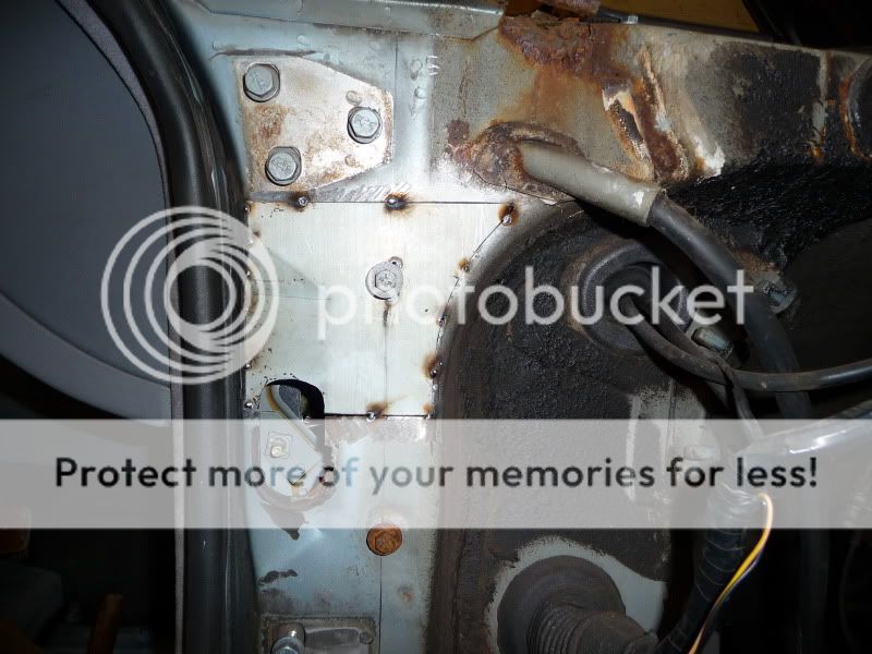

I took my old Sov down to Autofusion earlier this week for Dave and Gray to make a start on. I went down on Saturday lunchtime and found they have taken off both the front wings, so the dreaded inner wing tops are visible – and rusty. Driver’s door off too. Right hand side. This is typical inner wing rust on the late XJ40. Water gets in here and ends up on the front footwell floor. Properly crusty and flaky. I kept a rust flake as a souvenir – it’s surprisingly heavy for a Branflake. The front pillar has an unusual patch of rust in it. It is substantial and holed, but luckily only the outer skin is affected. The inside of the pillar is still as it left the factory. The guys cut out the rusty area, leaving this: New metal was fabricated and tacked into place: The repair will be invisible when it is finished. The sill end area is quite rusty on my car. A design fault creates a rust trap filled with road debris. This becomes waterlogged and is particularly bad on cars with a sunroof – like mine. The pipe to the right of the photo is the sunroof drain. It has rusted from the outside in, not from the inside out: All this was once hidden behind mudflaps, and invisible. A while back I noticed the driver’s mudflap was wobbly and a bit crooked. I was surprised and perplexed when it broke off in my hand attached to a flake of rust! The rust is barely visible from inside the car – just in the corner where you can see a crack in the seam sealer where the rust has swelled. On to the passenger’s side (RHD car): similar rust here - this area is an Achilles heal of the late XJ40, so the rust came as no surprise. Jaguar’s rust prevention seems minimal on the inner wing, there isn’t even any paint – only grey undercoat. Very crusty this side too – I can’t understand why my car didn’t suffer a footwell leak. It was garaged, so maybe only enough water to soak the soundproofing got in. The side view is also shows typical late car rust. The sill end needs tidying, but other than that there is no other rust on the left, likewise the right hand side is otherwise rust free. The XJ40 does not rust in the suspension tower behind the shock absorbers like the X300 and X308. They can rust badly there and it is not a trivial repair. A rather half hearted attempt at rustproofing from Jaguar in here – they don’t seem to have bothered with paint either. I wonder if the lack of paint is the reason why XJ40s rust so badly under the front wings? No paint here either… David

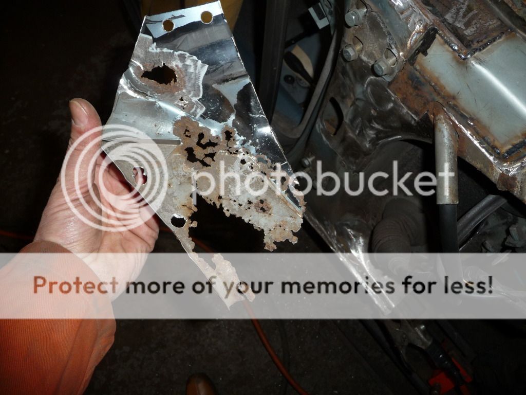

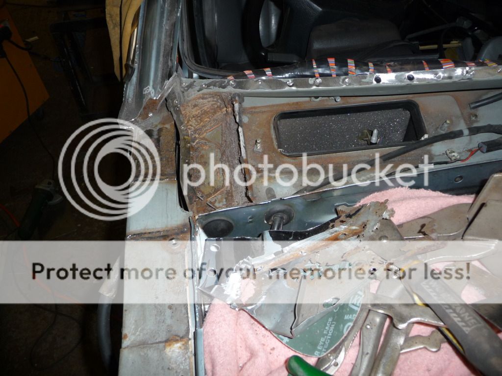

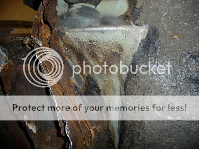

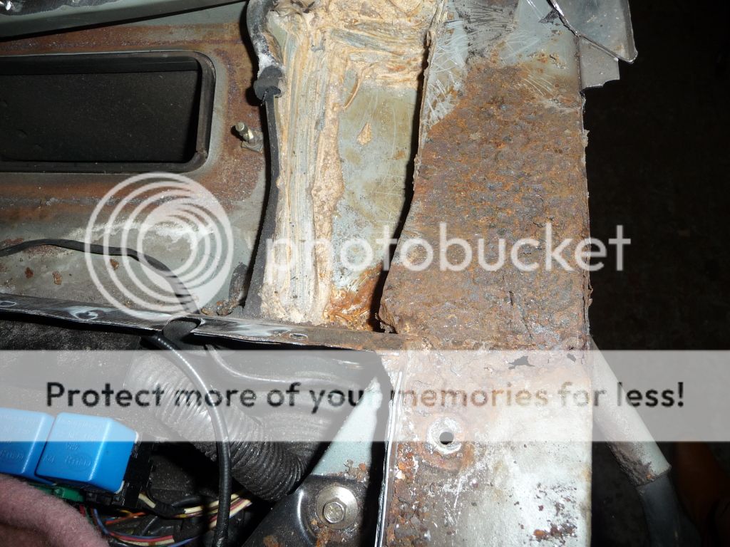

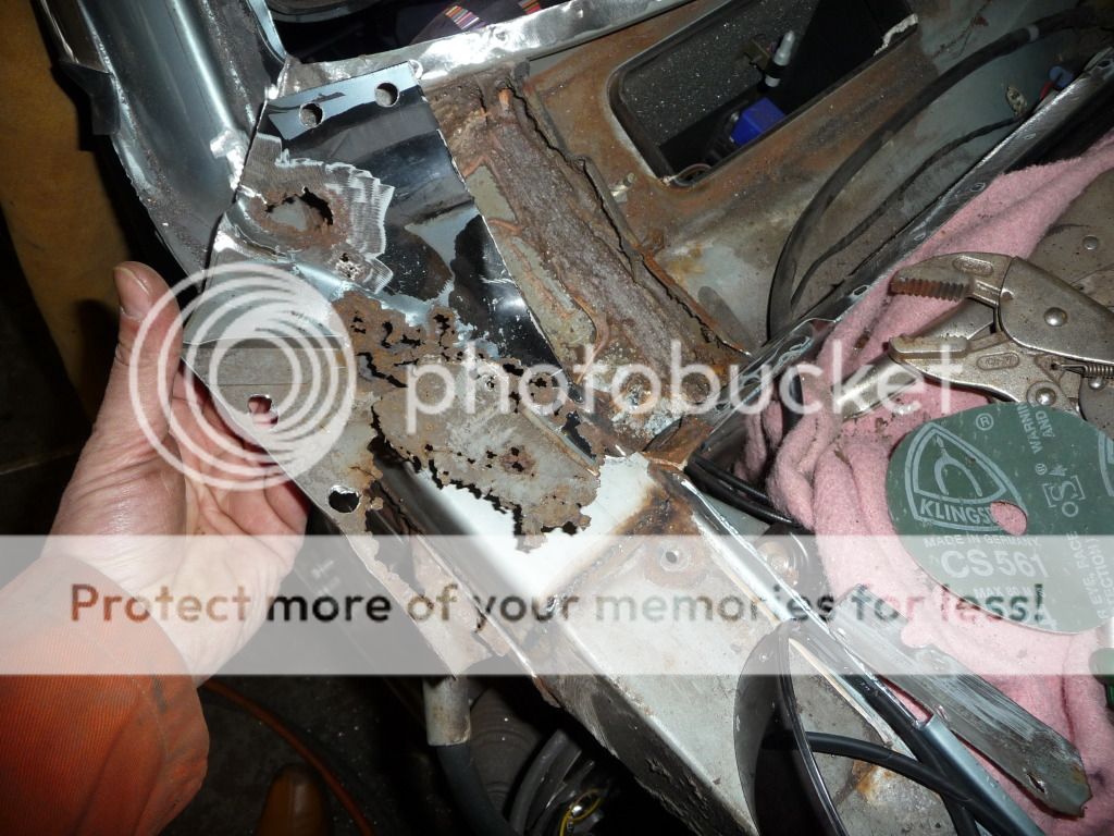

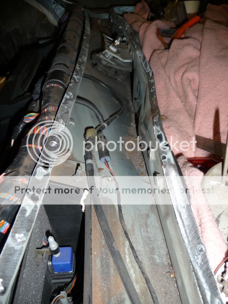

I went down to see Gray and Dave again yesterday and saw my car. I was particularly eager to discover what lies inside the bulkhead, under the scuttle. I have been worried about the extent of rust lurking here since the last time I was at Autofusion I poked my finger down the hole here and felt the rust flakes give way down below with quite a crunch. The same place without the front wing: The top scuttle panel has now been removed, revealing the inside of the bulkhead, which I am relieved to say is in excellent rust free condition. The brown staining is dust stuck on to a wax coating on the metal, and sitting on top of the seam sealer. I found it can be scraped off easily with my fingernail to reveal bright paintwork. The top of the right hand end piece of the scuttle panel. This is made from very thin metal, unlike the bulkhead below which is of much heavier grade. The underside of the same piece of metal. Water has got into this small rectangular compartment then been held there by what remains of the cavity’s foam filling. Dave described the foam as a rancid gelatinous slime. Water condensing on the underside of the top panel has rotted through the metal over time. However, the top panel is the extent of the rust. Despite the brown look on the photograph, the compartment's floor and sides are not rusty. The discolouration is a mixture of rust flakes and dust. The crunching sensation must have been my finger compressing the flaked remains of the top panel which had dropped through into the cavity. Some of the rust was close in texture to soil. Overview of the inside of the bulkhead cavity, now the scuttle top panel has been removed: Closer in: The whole interior of the plenum is in excellent condition – again the brown areas are a discoloured wax preservative. Photographed from the rear – there is a small area of rust where the bulkhead front meets the inner wing, but nothing more: The whole cavity viewed from the right hand side – no rust there: The small area of surface rust is the extent of it: The left hand side was in similar condition, but cleaner since the top panel was not so bad on this side. Viewed from above: And from the side across the plenum cavity from the left hand side: Again the whole structure is rust free: Clearly on my car water was not getting into the car from the bulkhead. It could explain why the cabin of mine remained dry, even though the car looked so rusty. David
