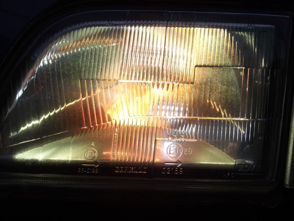

While I'm waiting to save up for to get the welding done, I've been doing a few little mods just to keep myself occupied! Fitted some Jaguar XJ6 interior door handles surrounds (direct swap - no mods needed), going to find some black handles to replace the grey ones. I'm gonna change the door cards at some point - possibly when I fit the electric windows. Before: After: Before: After: Changed the sidelights for some LED ones: Also fitted some Xenon front bulbs: I've picked up a Gti front splitter to go on and also an A-series tailgate!

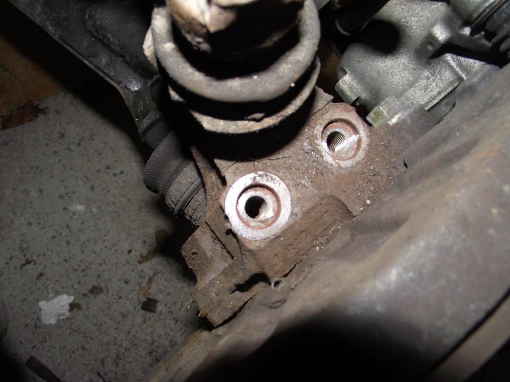

Well before Christmas I finally got round to fitting the front carpet, tried it with the sound deadening in but in the end I've gone for just carpet as it gives my big feet more space round the pedals! Had to hack it around a bit round the gearstick and steering column as its A-series carpet and they were located slightly differently. While I was in devon at my parents' for Christmas, Richard my brother (Rich606) and I changed my steering rack and arms and fitted my front anti-roll bar. We also fitted solid MGTF subframe mounts but in the end only fitted one as I didn't have enough of the correct bolts! I had one MGTF bolt and the rest were metro ones which don't have enough thread on them for the MGTF mounts! :nono: I made sure I bought some steering arm dowels off ebay before I started as they tend to get corroded into the steering arms or hub when you take the old ones off. Metro steering arm off. New dowels in. MGF steering arms fitted. Disconnected steering column from rack and Unbolted metro steering rack from subframe. Disconnected exhaust system from downpipe, removed old metro subframe mounts and unbolted gearbox mount. We then lowered subframe enough to slide rack out using a trolley jack and a shoddy old car jack!! We had to jack up one of the lower arms to get one of the subframe bolts out as the driveshaft got in the way. Metro rack out, then we fitted the MGF rack. Bolted that in and then had to faff around dropping the gear linkage and exhaust heat sheild to slide the front anti-roll bar in!! Finally in!! Richard's face says it all really!! Re-connected eveything, fitted one MGTF subframe mount on one side and one metro mount on the other and finished at 3AM in the morning! Re-connecting the steering column at nearly 3am started to try my patience a bit but we got there in the end!! Drives real nice now!!
