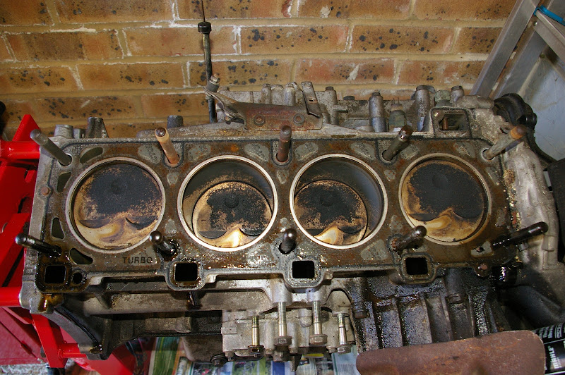

Thanks Sumpcracker! So the next stage of Hoff's life is underway - I guess it's the automotive equivalent of a "pacemaker" or "heart transplant". I pulled the engine out of the 944 from the top. I've detailed the process on my blog if you're needing to know how - link in my sig. After clearing the gubbins off the top of the engine, I detached the bellhousing and pulled it out. Now there's a big gaping hole there - that engine bay is big! Then off came the Cam Tower: ... and then the Cylinder Head to reveal four very large bores and coked pistons: The Turbo head gasket, fitted at some point in the past, looks like it has had better days - there were a few pin holes in it - I'm guessing that's not "The Bess" as Noche Libre would say... Besides looking a bit on the skanky side the cylinder walls are absolutely beautiful!
No marks, no lip, no scratches or scores at all. Quite incredible considering the mileage. I was expecting much worse but now I'm facing a little bit of a dilemma - rebuild this motor and keep everything original or the heart transplant I had in mind...

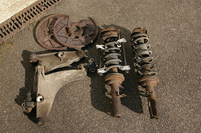

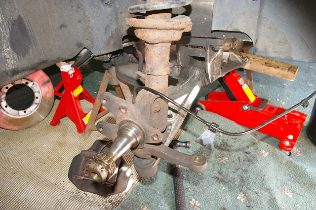

The worst summer in a 100 years or more should surely mean spending more time indoors - like in my garage... As there had been a serious power leak thanks to a loose main hydraulic hose connector the drivers (RHD) side of the steering rack, wishbone and cross-member are caked in a thick layer of grime. It looked particularly sad so I decided to begin stripping off the whole shebang for a thorough clean with a view to replacing knackered parts with shiney new ones. For the most part removing the rack is easy but when it came to the tie-rod ends it was impossible to loosen them when the rack was on the car. With the rack removed I could get the leverage to remove these 26 year old bits. Next it was time to clean the rack - I used some GUNK Green degreaser from Halfruads that did a great job. The aluminium and steel shaft cleaned up a treat - as you can see from the pics! Once the steering rack was thoroughly dry I painted the centre steel section with some Hammerite Smooth Silver. With the steering rack off it was time to tackle removing the whole front suspension. Apart from some stubborn 26 year old bolts the whole shebang was soon out... Everything is rusty and nasty looking. I want to get everything shot blasted now so when it all goes back in it'll be nice & fresh. The thing is I'm a little undecided about whether to replace the shocks or upgrade them...One things for sure though - it'll be lower!

The shocks I removed looked pretty mangey - they defintely need a nice clean up and paint refresh. Unless I ditch them for something adjustable... After removing them from the car I began stripping the shocks to inspect the dampers. Getting the top nut off is a little more awkward than I'd hoped. Apparently using a impact wrench will remove it but that failed to work, as the cylinder shaft just spins freely, so I needed an alternative method: I was surprised to find a brand new looking Boge Turbo damper inside the strut. There was a thin film of oil in the strut too - but perhaps that's to prevent the damper and strut fusing together as the damper looks in very good shape with no obvious leaks. Disassembling the second front strut was much more of the same but it's contents were quite a puzzle! The damper in the second strut - which was on the passenger/ left side is completely different and the strut was actually filled with stinky shock fluid... The two mismatched dampers I had on my 944 after a quick wipe: The condition of the Boge Turbo damper has me wondering whether I should just buy another one and be done with it. As it turns out the Bilstein B6 shocks I had been contemplating installing are not adjustable and that has me wondering just how much better they'd be than one of these Boge Turbo dampers. Alternatives are a set of expensive Koni adjustables or one of SPAX's reasonably priced coilover kits. Decisions, decisions...
