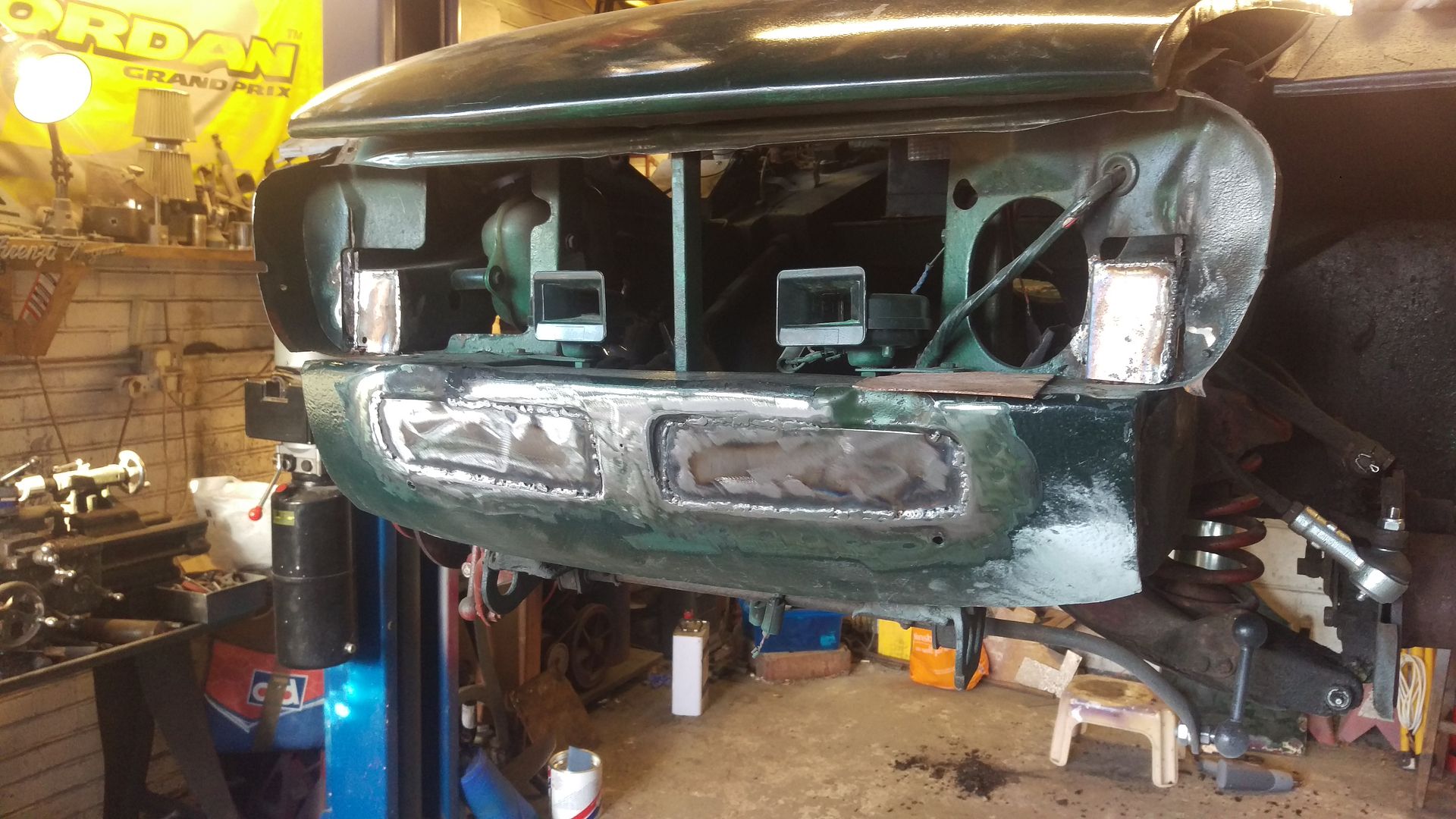

With the welding complete at the rear I moved up to the front of the car. Remember this? Well after I ground off the rivets and bolt heads holding the ‘repair’ on this was revealed. I made a patch up and as well as seam welding it I plug welded onto the chassis leg. The Midget is going to be bumperless and the owner wants a clean look so the 1500 vents were filled in with steel. This will have a skim of filler over the top to profile it. Next up will be to strip the underseal off then paint and stone chip the underside.

When the rubber bumpers are removed there is a large hole were the indicator needs to be. This is not on the earlier midgets so needs to be filled in. A piece of steel is shaped to fit… …welded in and ground back. This is welded slightly back from the front surface so filler can be used for final profiling. The same was done on the other side. Filler was used to smooth out the contours and a location hole measured out for the front indicators. More sanding and profiling of filler was used to cover the repair work on the other side of the car… …and attention given to the door gaps and levelness of the panels. I find this work tedious but satisfying at the same time. Hopefully the first few coats of epoxy primer will be going on in a couple of weeks.
