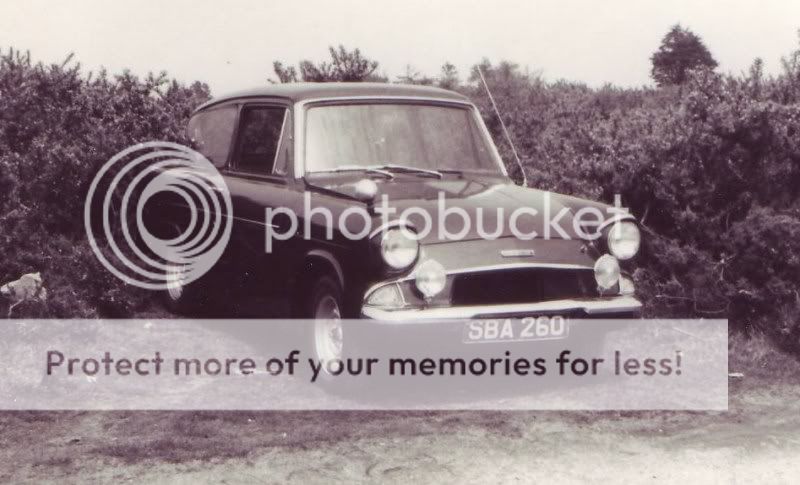

Damn, I meant to check that last night too. But got distracted looking through boxes of bits. Some cool old stuff in there. But what are these ones for? Never seen them on an anglia before, great kit you have there ,i'm so jealous i loved my anglias, have a piccy 1500 precross, 3.9 diff gt cortina rims and uprated suspension circa 1965/6

And mikemai47, that is an excellent little Anglia there. I'll be taking the tyres off the wheels next week, so will see what they look like after a blasting.
