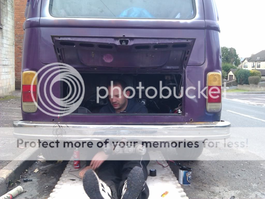

Hey all Refitted the engine back into my mates 72 bay camper last weekend after hes stripped it and completely rebuilt it,new everything,bearings the lot... problem weve got is now it starts,but either runs really fast or not at all,theres no idle Timings been checked,as have valve clearances and plugs,its a brand new carb The other thing ive noticed is that only one side of the engine is getting hot,removed plug leads from cold side when running and it cuts out so they must be firing somewhat... At a loss now,anyone got any ideas? cant help thinking its something small i just cant put my finger on it thankings before refit last weekend ;D
