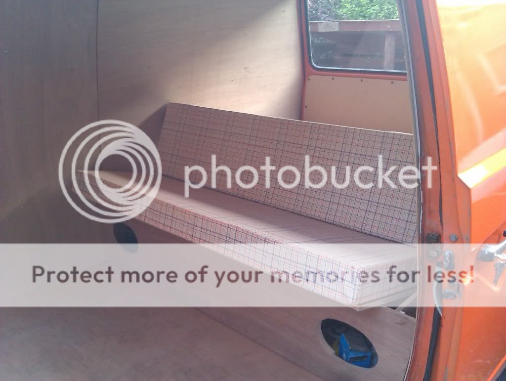

haha. Will look a big too familiar then don't you think? Would love to spray it in something green like olive green, something retro anyway... But still a long way to go... hey,nothin wrong with orange! Heres mine,picked it up last year off ebay for 600 quid,needed two tiny patches of welding and upper wishbone rubbers for the mot,i love it to bits,have been told that the panel vans are becoming quite sought after so try to avoid putting windows in it ;D All ive done is boarded it out,insulated it,full width rocknrolla bed and 240v hookup,and had it sanded back and resprayed as the original paint was faded to curse word
