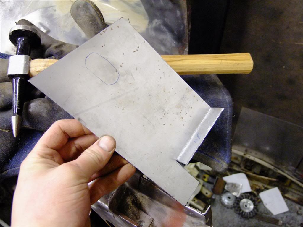

I started out template making - the first goes under o/s chassis leg to tie the two plates i've made into the chassis
Then decided that my time would be better spent concentrating on making a start on the other side so some more drawing followed - the plate has to be slightly shorter on this side due to the engine mount.
To give me this
Cut out in metal
Bent
And some holes
I then changed my mind and decided it looked better cut straight up as so
