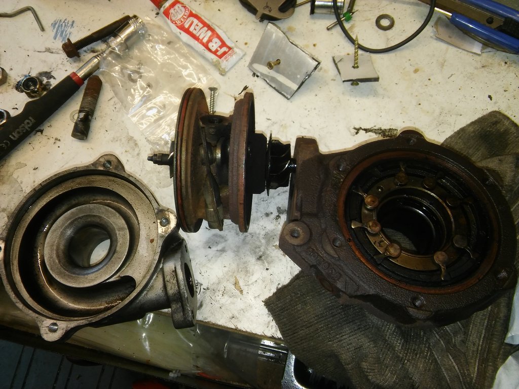

I have stripped down my old turbo and the core is now out was quite easy really, helped by having no snapped bolts or other fixings this is a question for those of you that may have already chipped in to this thread previously and might have knowledge of buying the cheaper end of ebay turbo cores - would the shaft assembly be balanced on those? cheers all

I have stripped down my old turbo and the core is now out was quite easy really, helped by having no snapped bolts or other fixings this is a question for those of you that may have already chipped in to this thread previously and might have knowledge of buying the cheaper end of ebay turbo cores - would the shaft assembly be balanced on those? cheers all I’ve not had one that’s come un-balanced. I should imagine it’d be pretty rare to find a CHRA that wasn’t.

I should imagine it’d be pretty rare to find a CHRA that wasn’t. ok, thats great.
