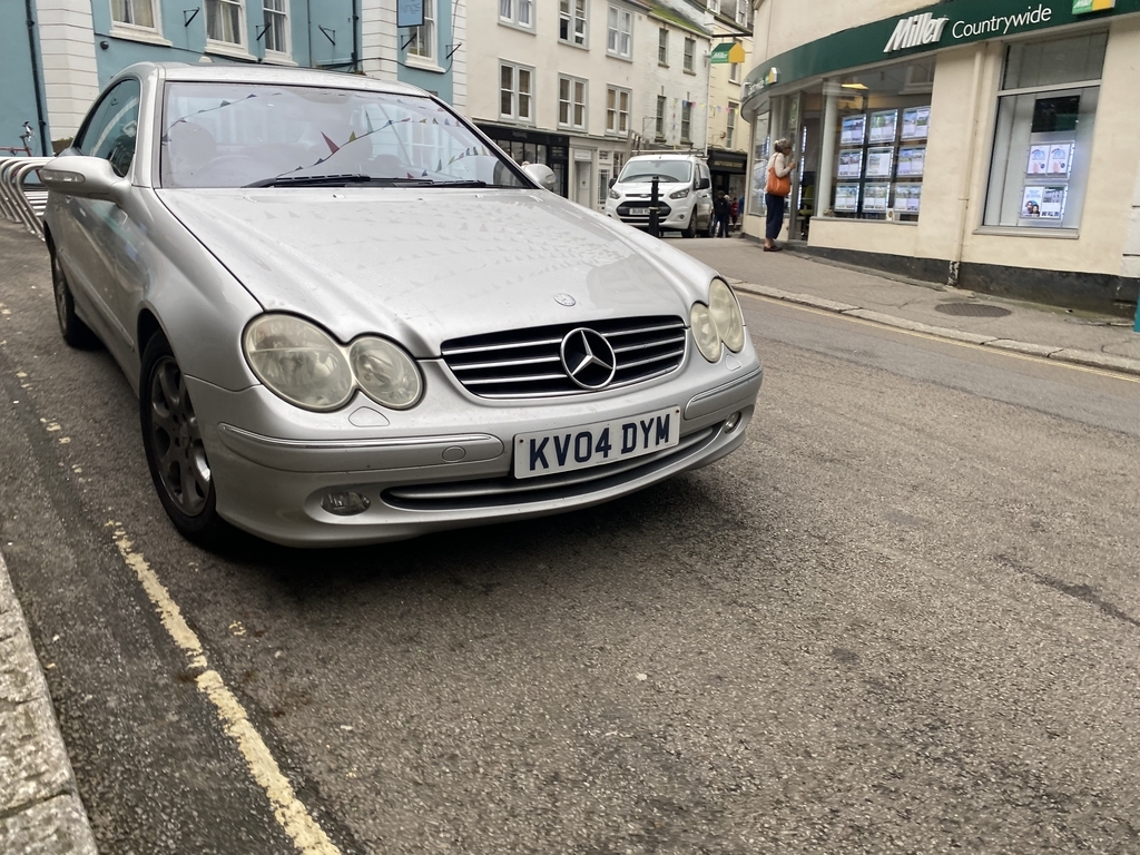

So, I would go to Lands End in this beast. Truth be told it was comfortably, and it soaked up the miles. I didn't push the car in the corners like I would, mainly as I'd had slidey moments in it closer to home. From being a man who had premium tyres on his cars, this was a mid-range/budget extraodanaire mix! It had -Rapid Pxxx Tyres up front -General Altimaxs on the rear. The Generals didn't grip much but they were progressive, while the Rapids randomly gave way in the wet when pushing on. Lovely! This would pale into significance. I would come to get into the car one day, and the windows on the driver's side wouldn't fully go up. If I am honest, they wouldn't even operate on the switches. Fantastic. This was just what I needed in a windy Cornwall. It seems Mercedes reliability had caught up with me. But at least I had some lovely sights. On top of this, the driver's side windows were slightly ajar. Remember, it's a pillarless coupe, so the windows drop to allow the doors to open. It was annoying to say the least, especially as it just began to rain. But at least the windows weren't fully open, only slightly ajar. It was annoying having only the indicator and central locking working on the door to say the least. But at least I could take in the sights. However, it's fair to say that with the journey back, I did have some wind noise. This was a bit joyous. Not! But at least the MPG looked good eh? However, once back at home, I started to strip down the driver's side door, noting the tricky to remove door seal which attaches to the doorcard. Mercedes clearly went to town with making the pillarless system seal right. But why was I removing the doorcard? To access this thing. A door control module. Despite it looking quite buried, removing it was quite simple. I decided to take a chance on this. Risky I know, but it was £50 for a replacement module from a Mercedes breaker. New they are £350, with Mercedes still carrying stock, surprising given there is a chip crisis in play. But then again, it's most likely older stock they have. But at least I managed to save some cash. How did I figure out it was the module? Luck basically. The only two things which worked on the door were -the Central Locking -the indicator on the mirror Everything else was dead. Mirror adjustment? No chance. Window lowering? Think again. Want to put a window down in the car from the driver's door? No chance. The boot opening also didn't work. However, after a couple of hours of being careful with the door, the car was back in business. All I had to do at this point was to do the classic thing of engaging in the following activity. Refitting is the reversal of removal. At the same time, I decided I had enough of the warped rear disks. So I went on to change them. However, being a Mercedes with 2 pot calipers on the rear, one of the pins had seized, and I bent one punch set. Being me, I went and got some Laser punches. These got the nearside pad retaining pin to move, but not the driver's side. As a result, I went in, cut the pin, and then drifted out the remains with a thicker punch. Eventually, I could get it out. On the other side, I cut down one of the thinner punches to prevent it bending so much. This seemed to do the trick and that side went more smoothly. It was fair to say that the old pads were quite worn. It was also interesting to see that the new pads had stainless steel pads, possibly fitted not only to quieten things down, but more likely added as a means of removing heat transfer from the brake pad to the brake piston, and thus in turn the brake fluid. Some neat touches indeed. The car then went and made a few friends. Firstly, there was my Mondeo ST220. While I did adore the ST220, there was no doubting that the Merc looked far more modern to me, despite the car model only being 2 years newer. Then it was time to compare it to some Swedes. One at Caffeine and Machine, the other at my parents place. I think it's fair to say that the Volvo may be the better looking car of the two. Not quite as old man, and with more of a modern touch. Driving both, I'd say the Volvo has the more refined engine over the Merc. Being a DPF'd Volvo, it was also less smokey than a remapped Merc too! The seats were comfier too in the Volvo. Instead of the firm German seats, the softer seats of the Volvo just swallow you up! However, the interior of the Merc I'd say was leagues ahead. Right from my W108 280SE, and the simplicity of my W124 dash, there is just something about Merc dashboards. They just seem well put together and ahead of their time to me. That said, I'm aware the Volvo setup was quite something when it was released. I used to like the S60s back in the day, but I've always been an estate man at heart, so one of those was never to be. It would also be one reason why this CLK would be moved on later on. Finally, this was compared to the Saab. Some folks like the Saabs and compare them to premium brands like the Merc. Comparing the two for me however is a no contest situation. They are like chalk and cheese. The Saab just looks more dated to me all round, despite the family one being an '07 Crossover car. That's to say, it has the earlier exterior but with the much improved exterior. I can see why the CLK was a success. Maybe I'll do a thread on the Saab one day, in a similar vain to the CLK one. That Saab however, I've maintained between a friend and my dad's ownership, so that thread would have quite a bit to unpack. Anyway, I digress. It's pic comparison time. However, this takes us now into around the 3rd month of ownership. The final chapters will come soon.
