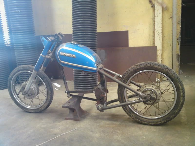

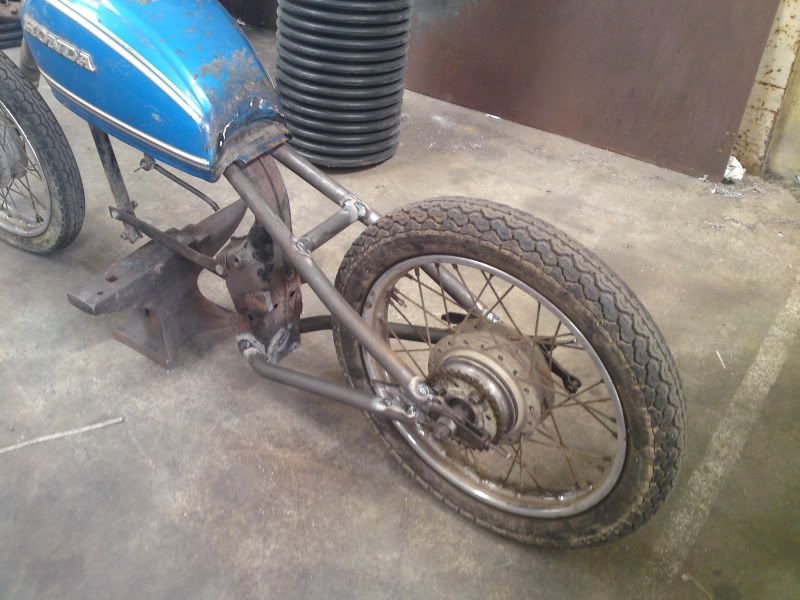

I've been on holiday this week so i went back into work and did this.... As you can see the whole idea of getting it on the road quick has gone out of the window. The frame is not finished as it needs a whole lot of bracing but i'm happy with it so far.

Nice plan & looking great already.
Jul 15, 2010 20:23:14 GMT
If you shorten the forks enough to make the tank level, it could be epic. Nice tube work btw!

Thankyou chaps,
I wanted the tank to be the same angle as the rear bars but unless i went for a silly wheelbase it wasn't happening. Might get another tank yet if one comes up cheap enough as about 2 minutes after these pics were taken it all fell over and bashed the original tank. You still got that in writing Joe? might need it if one day. How's that 100E motor going?
