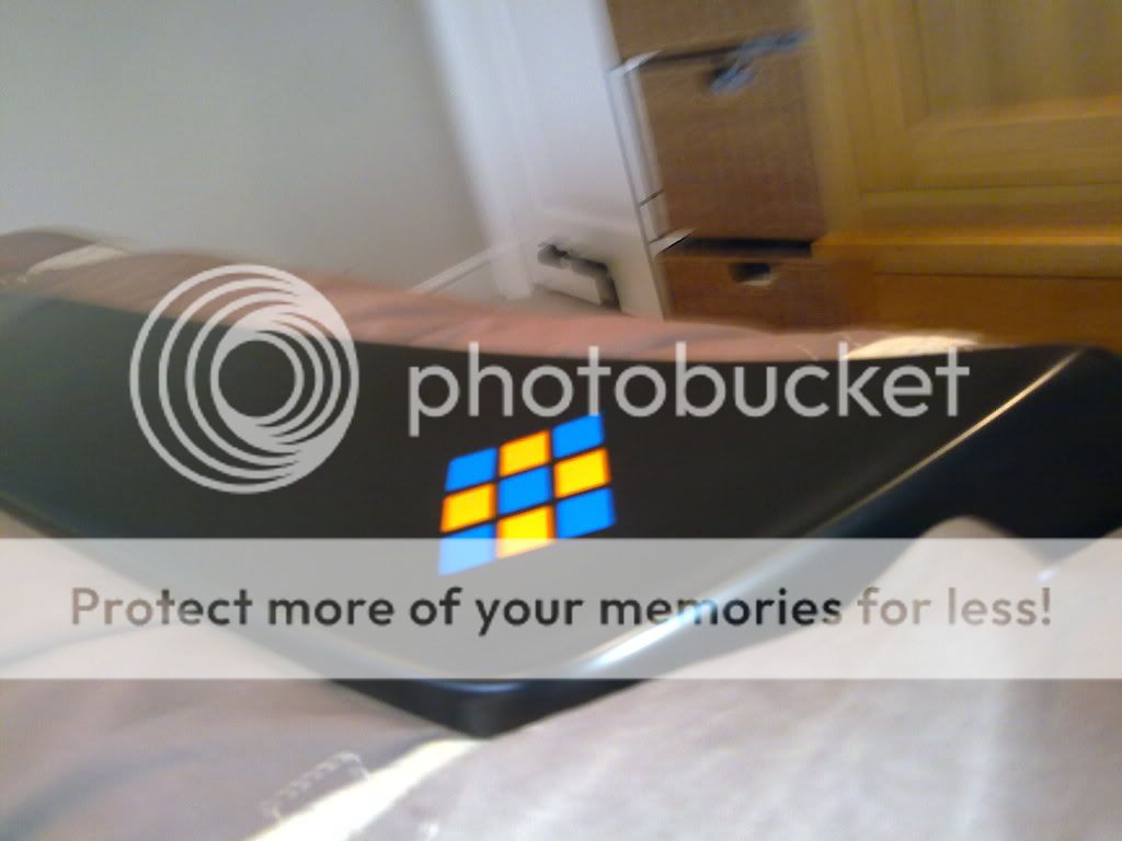

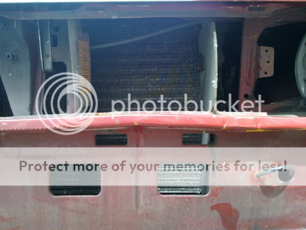

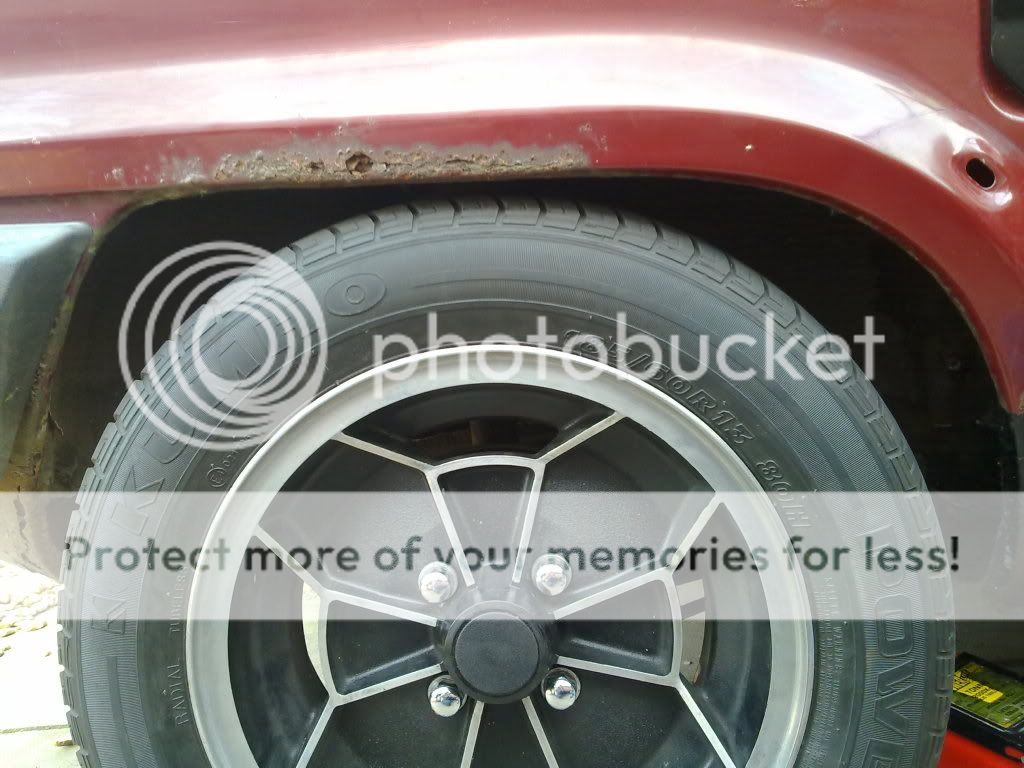

I got my Breadvan last year just before winter so it didn't have very much attention and was sitting on the drive for some time but as soon as the weather picked up I got to work. As soon as I learn to drive this is going to be my daily and I cant wait!! I began reviving the many rust patches she had, mainly on the doors and random patches, I haven't tried to do the rear arches yet as they are so bad they will need a welder which I don't have i'll continue to update this thread as I go along with the project hope you like what i've done. When I First Got her, The Rubber Duck was the first mod. Excuse the quicksilver in the background use to be my brothers car before he wrote it off :/ now he's got a Lupo!! In the winter months next to the lupo The Horror ahhh Fixed that hole with some aluminuim mesh and filler The SplitterBought a mk1 golf splitter off ebay trial fitting I didn't like the fact they come in two parts and you can see the line down the middle so I fibre glassed them together Wet and Dry'n Primered Painted Satin Black- did it use to be in 2 pieces? love itt Went to Dubfreeze 2010 and got some awsome retro stickers Fuel TankMy fuel tank was leaking so it was time for a new one up on the ramps all that mud fell out of there could of made a vegtable patch or somthing with it old and new The Custom GearnobTheme for my car is retro so whats more retro than a Rubiks cube First I had to mark out the sqaures on the top face and to cut them straight my step dad made a jig Then once i'd done all the sides I threaded a hole in the bottom and test fitted it on my gear stick I then rounded all the edges off, sanded it and primered it Then sprayed it black Now for stickers Comparison finally fitted I love the way it came out Custom Filler CapThe Design Primered Black soo shiny Stickered On Car The GrillMy mate brang round his tape he used to do his bumpers on his mk3 coupe and we done my grill Before After My Car as it is now, the splitter and grill are not on because I need to fix some damage on the front Tell me what you think , more to come soon Jordan

I love that Gear Knod, Simple idea beautifully carried out! Nice, and the splitter looks the sex too smoothed off, just need to get to grips with the body! Good work!

Just as a tip, since yours seems to have similar rust spots to mine, lift the rear seat and remove the driver's side door card, you *might* find some rust there since water and grot gets stuck between the filler neck for the petrol tank and the inner arch. Oh, and check your battery tray, they can rot out from there and straight through the bulkhead so be sure that's clean and watertight, we only found that hole on mine when it rained... but it's fixed now.

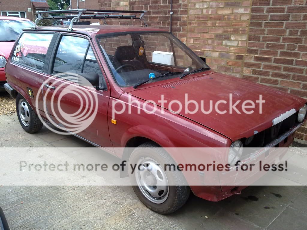

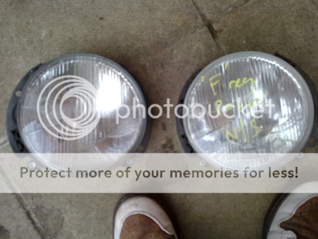

Update Time hey peeps thanks for the comments not really a big update but a few random things i've got up to, enjoy! Rubiks Cube sticker on splitter Rang up like 20 scrapyards to see if they have my car, eventually one said they did, 2hrs away, so went there and it was a mk3 what a joke, lukily the sun visors are the same and he had some mk2 headlights on a shelf so snatched them up Put visors on and changed my cracked headlight The Breadvans been having idling problems and keeps cutting out, turns out it was to do with the air/fuel mixture so adjusted that and now she's running like a dream Started working on the damage on the front, partly my fault and some was there before :/ This kind of worked looking better now wet and dried it and fillered still needs sanding though then will be ready for paint have no idea how it will turn out as i have to get halfords to mix my paint which is ment to be metalic when my car is faded :/ Bought an old skool thule roof rack, ebay bargain of £10 bit tatty but i've dismantled it and going to restore it In the middle Or on the back I like it on the middle better, what does everyone else think? Thats all for now guys, oh yeh i have bought some wheels You guys may recognise them from the forum I'm so glad I'm the new owner they're great volksangyl was right, i'ves been getting water next to the throttle pedal so checked the battery tray and found this Cheers Jordan

roof rack looks better on the back imo. love the job youve done on the gearknob!

Update Time volksangyl was right, i'ves been getting water next to the throttle pedal so checked the battery tray and found this If you're getting water on your pedals then the rot has gone through the bulkhead too. The repair usually requires the dashboard to come out, which isn't much fun if you're not taking the windscreen out. However, the good news is that your battery tray hole is far smaller than mine so it should be an easier fix. I'm amused that the pattern of paint and metal damage on the nose end is identical to mine when we stripped it back. In fact, the areas of damage on yours are so similar to mine that I've listed what I've found on mine when we stripped it back to the bare shell for your convenience: surface rust in spare wheel well. bottom front inside corner of driver's door top, back edge and near jacking points of sills Rear valance where it's close to the spare wheel well Hinge on fuel filler flap (though I think you've already tackled that) The plastic inserts in the wheel arches collect a lot of mud and grot too If I think of anything else to look out for, I'll let you know. Feel free to ask me about bodywork and interior related stuff, but be aware that I'm not so hot on mechanical things.

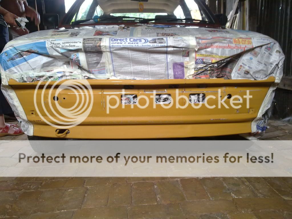

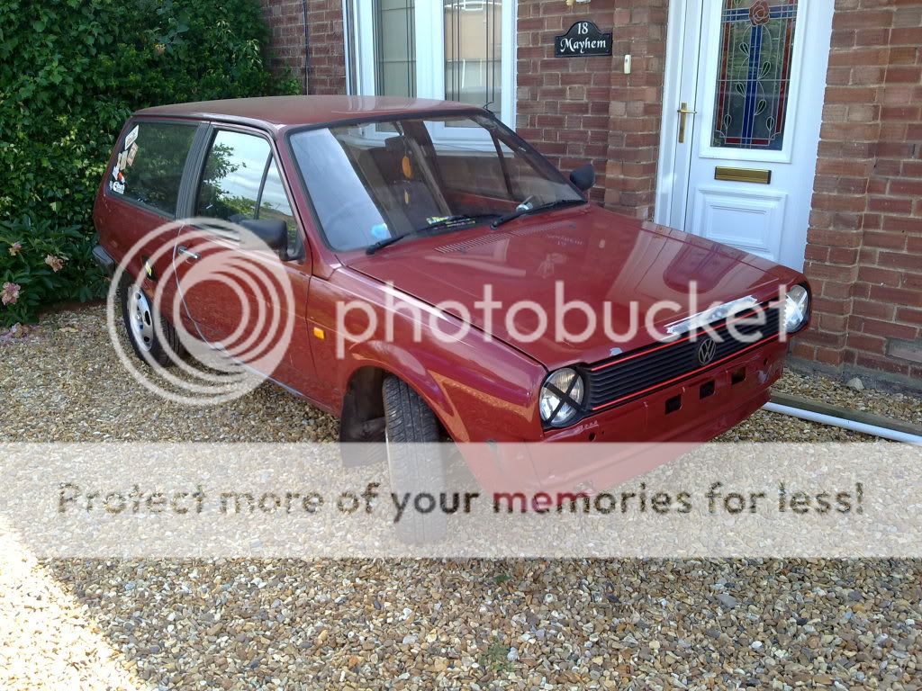

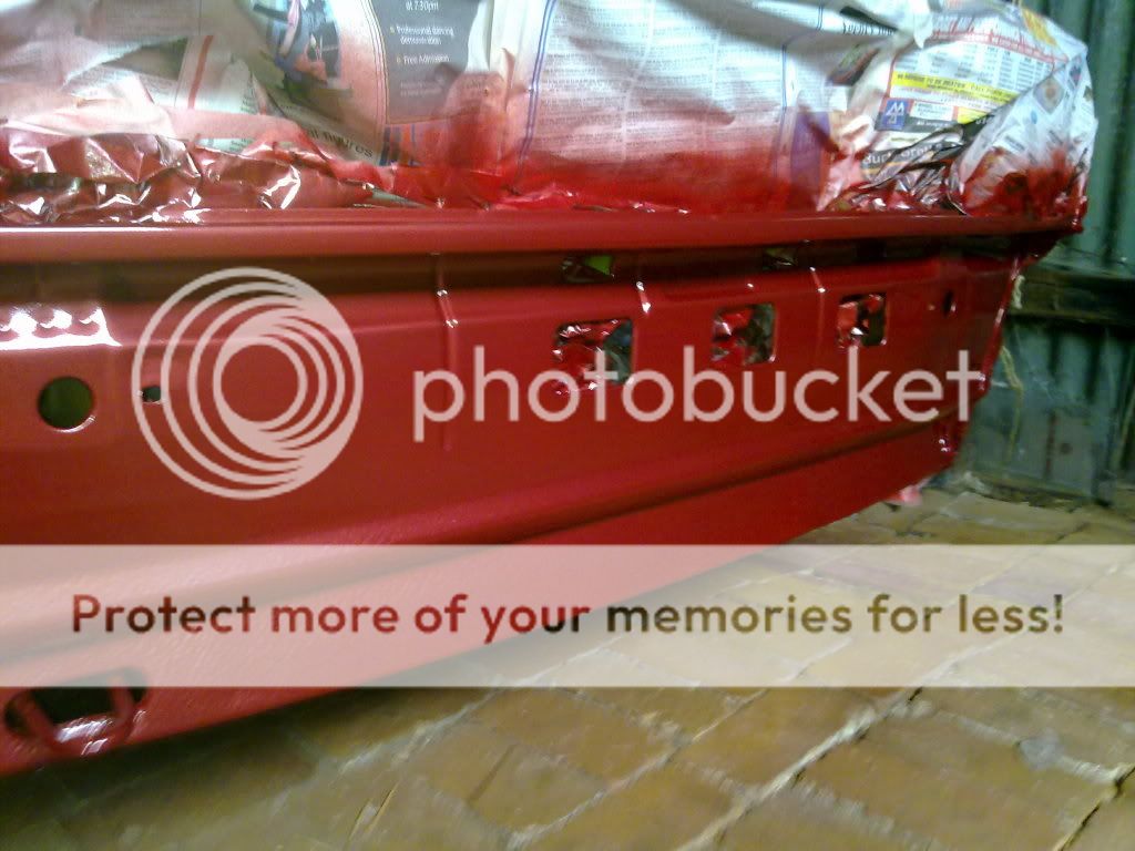

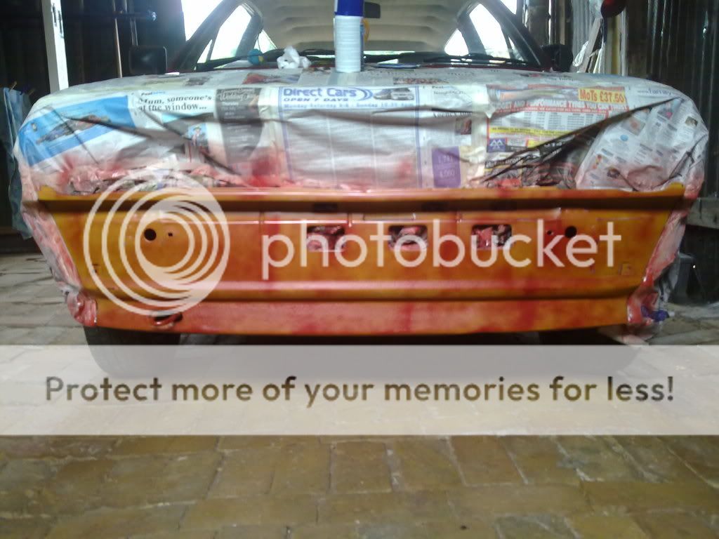

The week the Breadvan got its face back I fitted my new wheels on the back to see if they fitted in the arches, i need spacers for the front as they don't get over the calipers :/ I need some camber shims compared with other side Prepared the bready for primer my legend of a next door neighbor let me use his garage wet and dryed ready for Titian Red first coat Painted, i love the halfords mixed cans they're so good even though expensive :/ Clear coat i cant believe how close it is to the original colour, considering mine is majorly faded love it! got the grill back on Next time ..... wheels, roof rack, splitter and more i hope cheers Jordan

Nice work with the bumper. Looks really clean.
