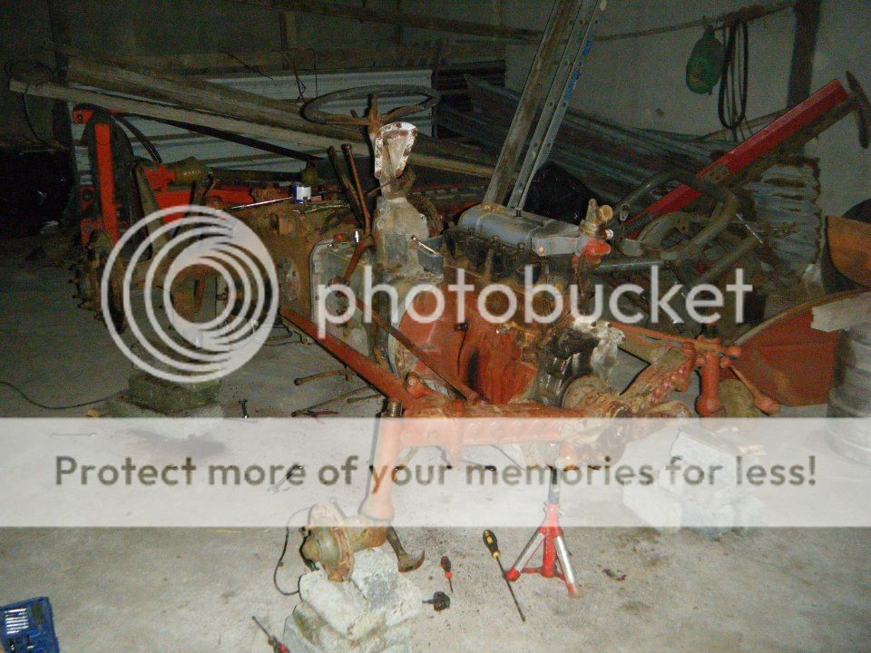

Well I've been lurking for a right while now so I suppose its time I made a thread. I bought this TE20 off Ebay a back around November or so for the princely sum of £621 (With a Ferguson Fingerbar mower). I rolled it off the tow truck,got her going,drove about for a few hours and then drove her into the shed and started stripping her down. The tractor was an Anglesey tractor all her life. Registered EY 9997 in November 1951 to a Mr. Thomas. I bought her off the second owner (of 2/3 years) back in November.  1. One of the photos off the Ebay add.  2. Another photo from the Ebay add.  3. The tractor landing in the yard many weeks after I won the auction. Not as good looking as she was in the auction photos but not in too bad off shape.  4. Got her going after awhile. Drove her about 2 miles about the place with a very sticky clutch pedal. Not fun.

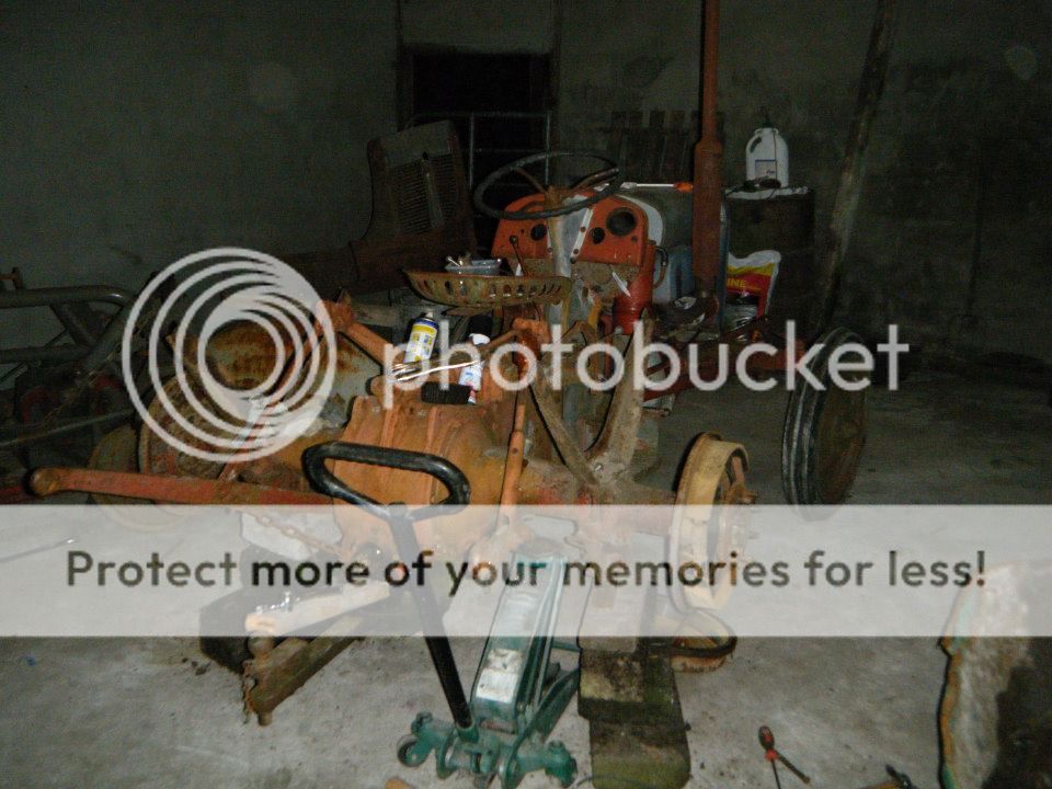

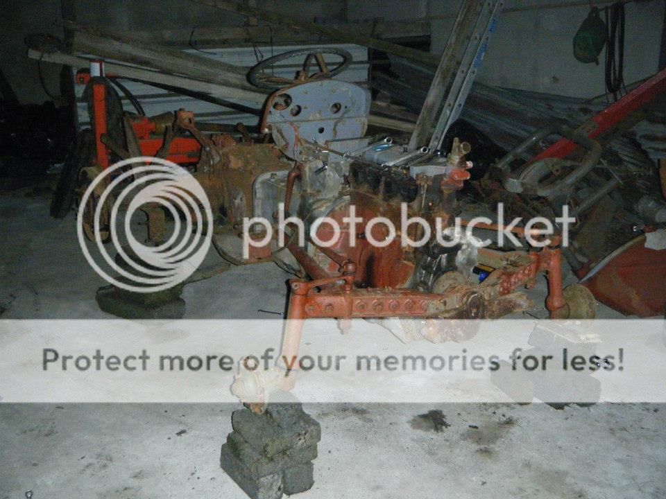

 5. The strip down begins. Bonnet off without much bother. Mudguard skins (which are new) came off no bother. Brake drums came off suprisingly easy after the 2 retaining screws were loosened.  6. Seat off no bother. Radiator off,needs to be flushed out and a bit of welding on the fan shroud. Exhaust and studs all came out easy.  7. Dashboard off which was abit of a pain. Rusty screws which have been in there since 1951. Footrests off. Wishbone and steering arms off.  8. Grinding,sandblasting and wire burshing my way through the rust and paint.  9. Getting there....  10. Bare bones of the tractor now nearly fully sanded and given the first coat of primer. Quite a few of the small parts also sanded and primed. Thats all for now,More soon.
Last Edit: Feb 18, 2013 23:56:51 GMT by sa1clover
1951 Ferguson TED 20 / 1988 Ford Sierra Sapphire 2.0 1990 Isuzu Bighorn 2.8 Irmscher R / 1991 Pajero 2.5 SWB 1991 Vauxhall Carlton GSI3000 / 1991 Toyota Corolla van 2.2TD 1992 Toyota Corolla 1.6 GTI / 93 Ford Granada Scorpio Cosworth 1994 Toyota Corolla GXI / 1995 Toyota Corolla 1.6 Si 1995 Nissan Vanette / 1997 Toyota Starlet 1.5td Glanza 1997 Toyota Carina E saloon / 1998 Toyota Carina 2.0 Exeuctive

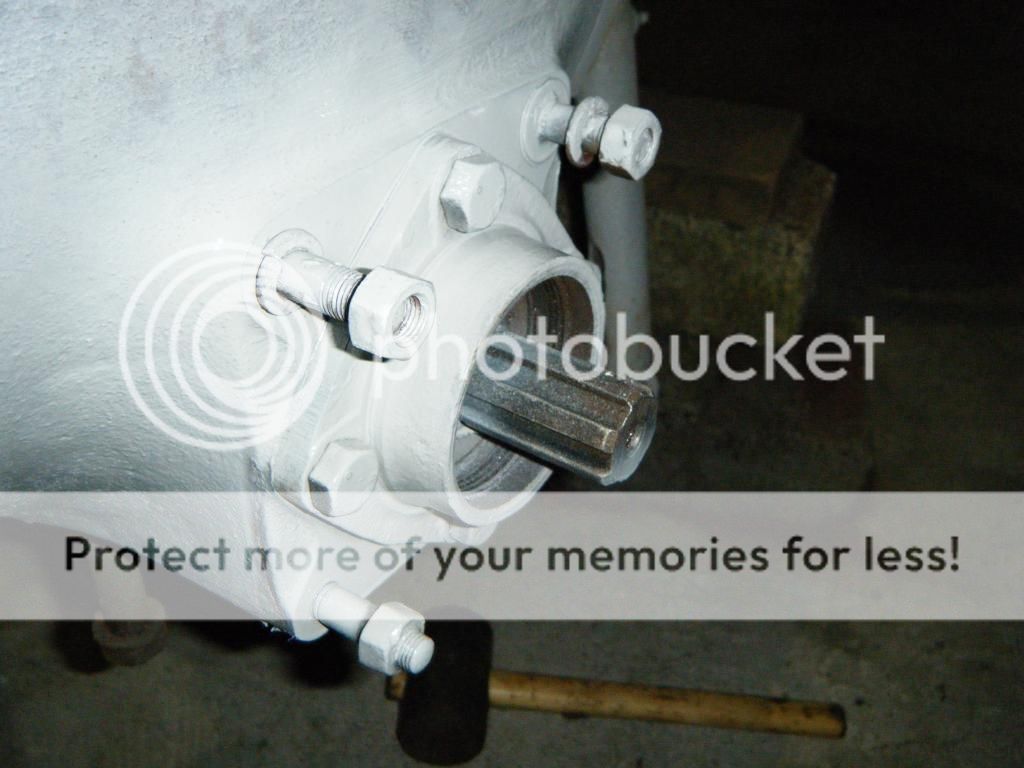

Remember unless its had a conversion that PTO shaft is a smaller diameter to modern stuff, you will need a sleeve if you want to use a larger one. Remember to change to rear diff/ hydrolic oil ours have always looked like marg when they came in, super universal tractor oil isn't really suitable, they were designed to run straight weights of oil - it works better and they are quieter

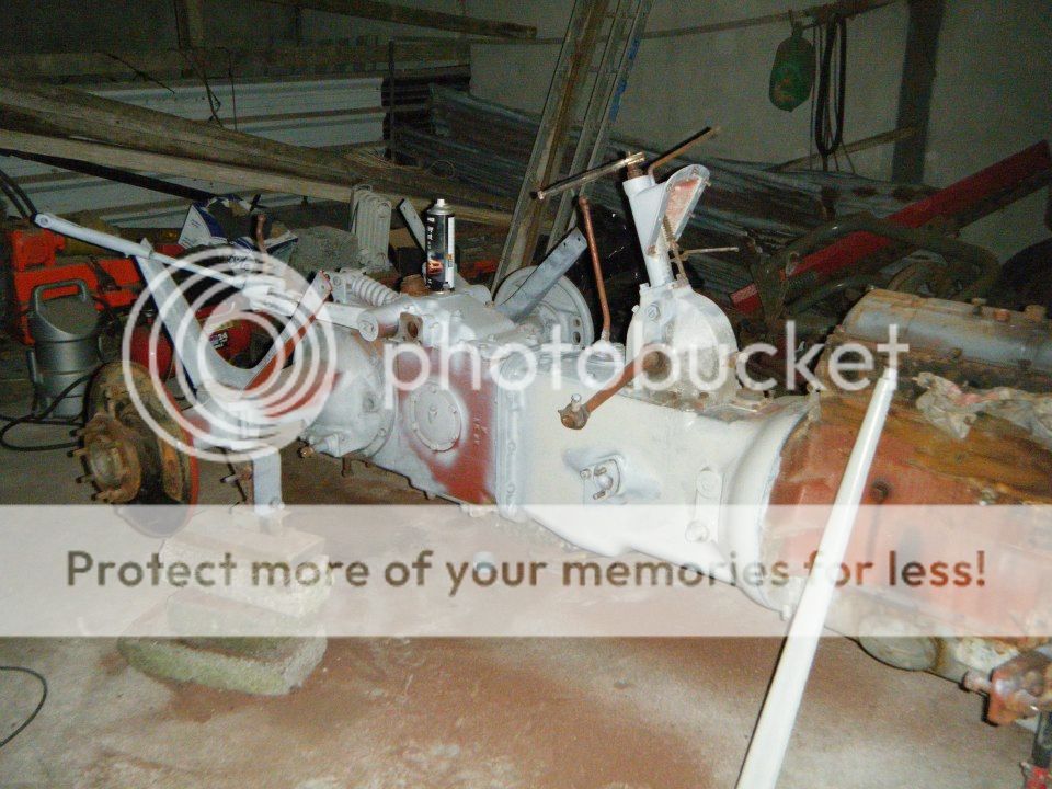

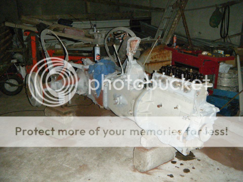

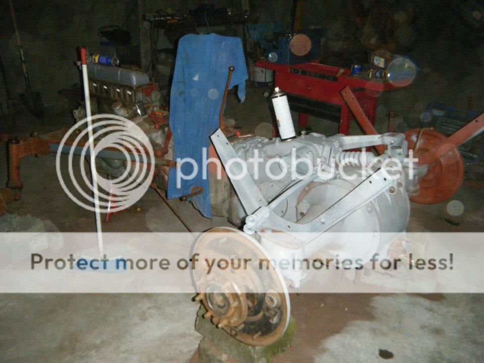

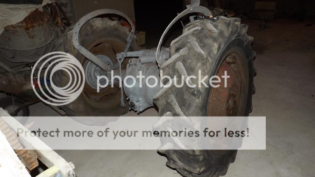

I have the PTO shaft increaser. You need it for the type of mower that came with it. Slowly buying bits and pieces for the tactor (2 PTO covers, both the wrong size -.-). Not much to update on, anything that I have done recently has just been sanding and priming small parts.  12. The T20 moved home earlier today. Simply put the back wheels back on, put a chain around the fulcrum pin (Front axle pivot) and lift the front of it up with the matbro.  13. View from the back. Not much to do here before primer and topcoat goes on (Wheels being done separately).

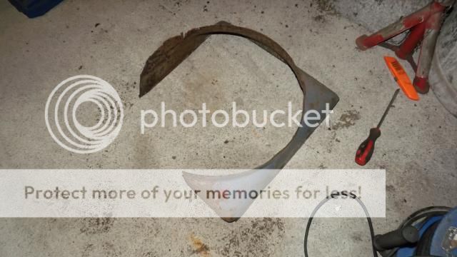

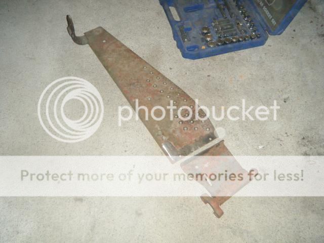

 14. Back wheels sent away to be sandblasted. Normally costs €30 a piece but I got them done for €20 a piece. Photographed when I was priming them.  15. Second footrest with rivets ground out. Had some heavy rust but thankfully has not rusted through. I don't think I'll go at it with the welder.  16. Taking the cowl off the radiator. 7 flat head screws in total. Amazingly all 7 came out without much fuss.  17. The cowl itself. Would need a ton of welding and patching. If I can't find another one I might try and repair it. Can't bear the thought of paying for a new one though.. A brand new thermostat housing bought on ebay for £11 in total. Normally they cost around £35-£40. Not so bad I think.
